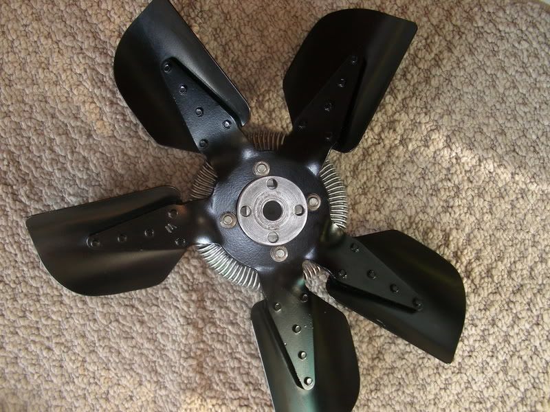

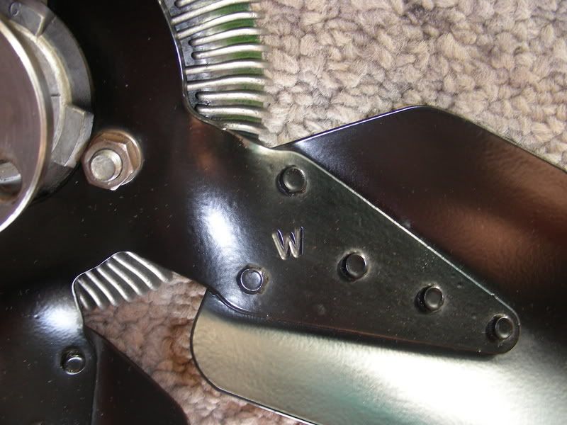

          Jim,
          If this any help, here are 2 photos of my 67 L-79 fan.
          Rick

            Re: Factory fan 1966 L79
            Jim - Yes, the fan is still available but there are some differences to look for from the judging perspective. My experience is that the new SERVICE fan blade assembly does not have the "W" as you can see on Rick/s photos and many of the new Service fan blade assemblies have a balancing weight on one of the blades and I don't remember seeing any of the "older" original fan blade assemblies having a balancing weight. Pete

              Factory fan 1966 L79; watch out for "FRONT" stamping
              Jim,
              Also be aware that some currently sold new fans will have the word FRONT stamped into the hub area, in very large letters. As far as I know original fans have an H stamped into one side of the hub area and, as Pete says, a W stamped toward the base of one of the blades on the other side. But no FRONT stamp.
