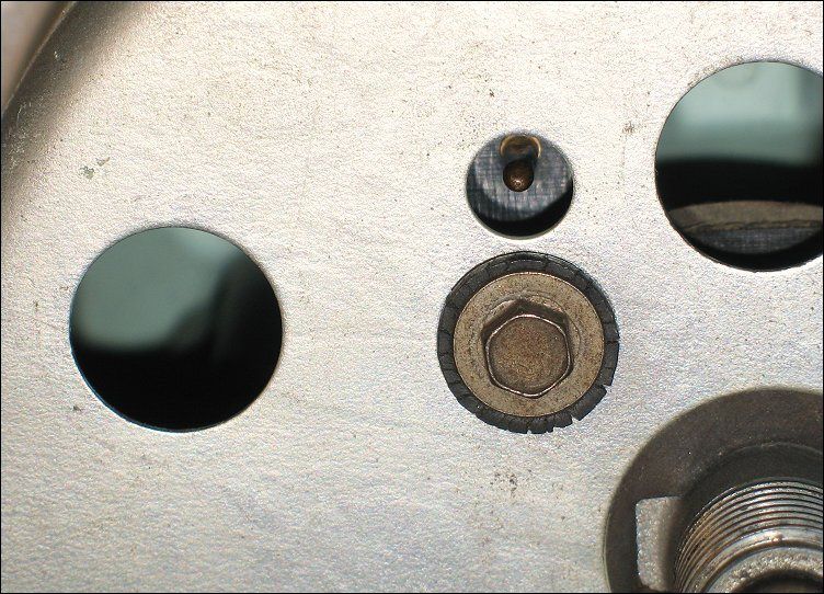

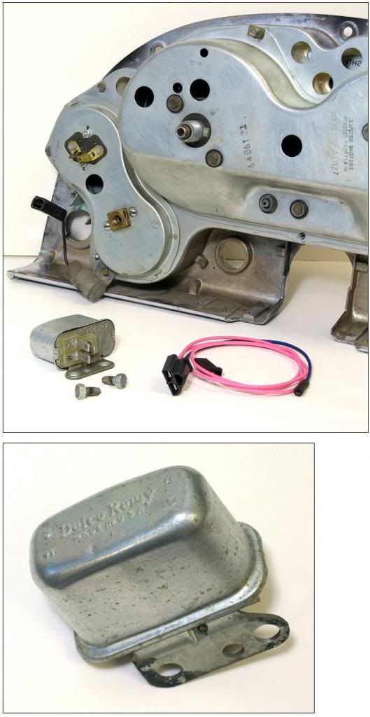

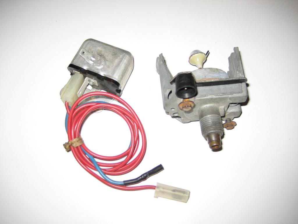

          Ed,
          Here area few pix of the pin at the back of the tach, and another of the buzzer and harness.
          Mine are actually out of my car right now if you care to see more pictures.
          Monte

                          Re: 63 Tach warning buzzer question
                          the harness connects to the back of the tach on one end, and to the buzzer box on its other end.my early dec 63 had the buzzer tach and the buzzer but no harness. the cluster had never been out of it before me. i made up a bubba harness and then started the 360 engine. couldn't hear squat. then i took a drill motor to energize the tach, with the engine off, and could hear the buzzer--but barely. mike
                            Tim, the harness connects to a small pin inside a hole in the back of the cluster. The hole is shown in the pics in post #10. The center RH pic shows the pin. The hole is shown in the top pic, it is the small hole, above and to the left of the tach cable connection, just above the screw head. If you want one, I believe the harness is (or was) available from Lectric Limited.
                            It might be futile to put it on, though, as Mike said, you'd never hear it at red line. Since nobody checks for it in judging, or even knows if it should have been there in the first place on your car, I'd leave it off, as I did on car 3922.
                              The harness is still available from Corvette Central for $21.00
