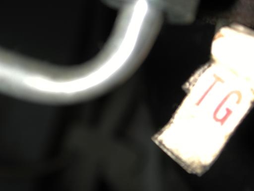

        I have a very original Oct'71 PB car with the original broadcast tag still on the bail. You can see it at
        It's not a very good picture ... I can take a better one if you need it.

          I don't have a 1972, but before we put that bail tag information in the TIM&JG we looked at a lot of them, and have been looking at Bowtie cars for a while too. We were looking before anyone was reproducing the tags, so we had good data. Trust it, in spite of what Paragon has been stating for years. While I have never talked to Richard about it, I suspect they are advertising what they have available to sell.

            Mike, thank you for the photo. It helps a lot. Terry, thank you also. I have relied almost exclusively on the 70-72 JG during the judging process for my 72, but I did find an error or two. So, with that in mind, I had a nagging feeling about a TG tag on a PG stamped MC. You both have helped clear this up.
