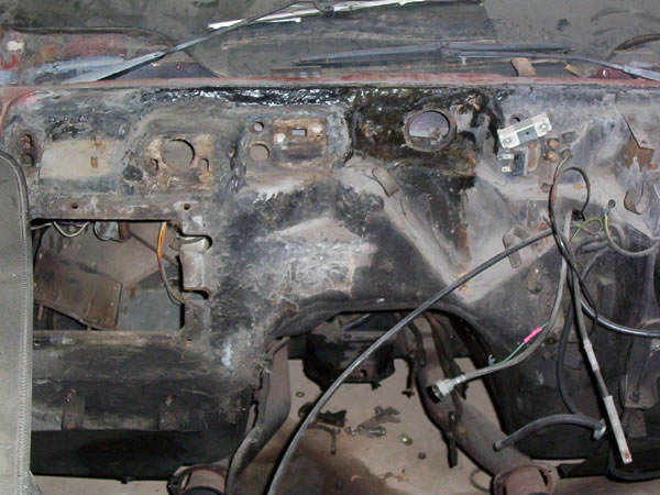

    How would you fix this?
    I have a '70 LT1 that has had an engine fire in the past. I have the engine out now and while it is geting freshened up I'd like to fix the damaged firewall. At first I assumed cutting out and replaceing the panel would be my best bet. It is in pretty bad shape and the even the toeboard is weak and floppy. I still think this might be my only option. One problem is that I can't find a replacement firewall section or even a good used one. Take a look at this picture www.cliftongarage.com/vettefirewall.jpg and let me know what you think and how I should go about fixing it please. Also if anyone knows where I can get the panel please let me know.

        Re: How would you fix this?
        George: I helped a freind repair sun damaged glass on a midyear car and I think it was actually worse than those pics. The glass was weak and you could move it back and forth. On your car I would clean the still solid areas down to glass with sand paper and laquer thinner then I would strengthen the weak areas with west marine epoxy resin with powdered glass and put some of sermershiems black die in the mix. Use hard cardboard for a backing on the best remaining side and apply the resin mix on the other side. Your car does'nt look as bad as I "know" it is but if this area is the extent of your damage then why replace the panel? If the studs for all the accesories are still holding in the glass then a good reinstallment of resin and alot of hand sanding should make a real nice looking repair. The west marine stuff is much much easier to sand than the old polyester resin. Remember all of this gets painted semi black before assembly. David
          George I would use resin and glass but tear up the mat and build up the weak areas if it is not burned thru. Lyle
