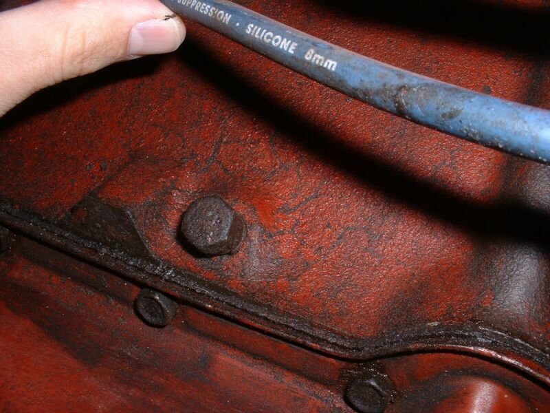

      • Brian Monticello
        Re: Cooling water drain plugs
        Passenger side is shown below
        and here's the driver's side (notice the dispstick bump-out on the oil pan). I don't think this is supposed to be a hex head
        I got lucky and these came out super easy. On the passenger side the coolant was dribbling out so I moved the bucket - Poked a small screw driver in the hole and coolant spewed out like a waterfall - missed the bucket and got my light wet. A whole bunch of garbage came out with the coolant.
