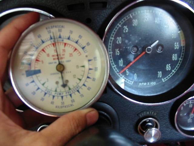

                          • Byron Martin
                            A pictures worth 1,000 words
                            Duke and Ed,
                            First, let me say that I read all the corvette forums frequently and I value Duke's opinion. Duke knows his stuff.
                            However, I can assure you that my engine is completely stock, with the exception of the camshaft. It has been in my family for 35 years and I know its history well. It will idle at 6-700 rpms and maintain 16 inches of vacuum. It idles nearly as smooth as the original cam and has plenty of power down low.
                            I took this picture just for Duke.
