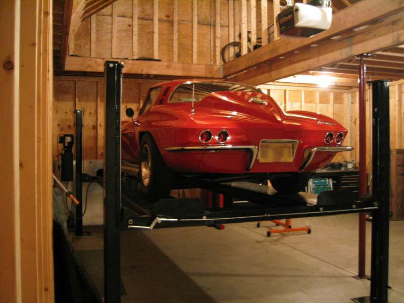

                          Re: Need a Lift--Comments Appreciated
                          I have a Cytech Double-Park (www.doublepark.net), very pleased with it after four years' use. I had my garage doors and framed openings made 8' high (vs. the standard 7') so the lift can be moved outside if necessary; I don't think any lift on its casters will fit under a 7'-high door opening. Also had the garage door in the lift bay set up as a "high-lift", with the horizontal tracks 8" from the 12' ceiling so I can have the door fully open with a car at full working height.
                              Would have been disappointed if you hadn't shown up with a pic...
                              As John well knows, I have 2 of the Cytech lifts. I love them and wouldn't trade them for anything. Another NCRS member locally also purchased one and has zero problems.
                              I love the casters, but also find that the powdercoating and finishing seems much better than other brands I've inspected.
