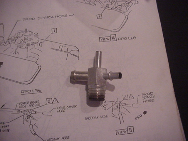

    does the 69 tri , use this retainer or not for the vac hose to distrib?
  • Jay Griffiths
    Re: 69 tri-power vacuum advance tube retainer
    The tube and retainer are only used on NON air tri-power cars. If your car has air then the distributor advance can should be hooked up to manifold vacuum at the fitting behind the rear secondary carb. The following picture show the fitting used for a car with air and power brakes. View B in the picture is the fitting for manual brakes.
    Jay
