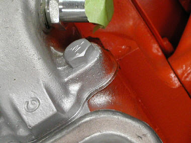

                    Here are some pictures of a 66 motor I painted earlier this year:
                    My personal interpretation of how it was done.
                    Patrick
                    • Michael H.
                      • January 29, 2008
                      • 7477
                      Re: Aluminum Spray
                      Patrick,
                      The silver looks good. I especially like the little wisp of silver that wrapped around the front of the cyl head. Looks real.
                      Do we get to judge the rest of the engine now?
                      Michael
                        • 11608
                        Re: Aluminum Spray
                        You get to judge it if it's something easily fixable without having to ruin the nice paint job.
                        Any thoughts?
                        Patrick

                          • Bill Stephenson
                            Re: Aluminum Spray
                            Patrick,
                            --------Not much of a big deal, but wouldnt the valve-cover gaskets have been silver along with the adjacent head surface? Over all, though, a thumbs up!!!!!.........Bill S
                              • 11608
                              Re: Aluminum Spray
                              Yeah, I know. I may yet touch up the valve cover gaskets, but they have to come off again to adjust the valves, so I'll consider it later.
