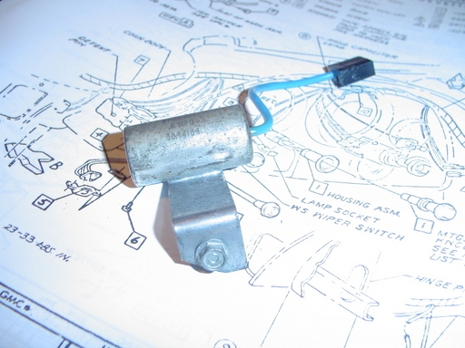

    Dear NCRS,
    I took apart my dash and instr. cluster and this was on the floor afterwards. It reads 'Sprague' on top, then '6MFD' in the middle, and '3844184' on the bottom. I checked my 67 Assembly Manual and I think it can be either one of two things, but nothing set in stone. Any idaes? Thanks much!
    Justin #41362

    It's number 6 on page G452 and the little nail goes in the tan wire. By the way you have the screw in the wrong way. Turn it around.

      Thanks for the help! I haven't checked the manual yet, where does the little screw hold down the unit. Does it go into the back of the cluster, support bar or what?

        Check it out in the AIM on that page and you will be revealed all.

          see UPC U69 A5. It is wired into the parking brake indicator lamp
          Randy
            U69, Sheet A4, item #6 *NM*
