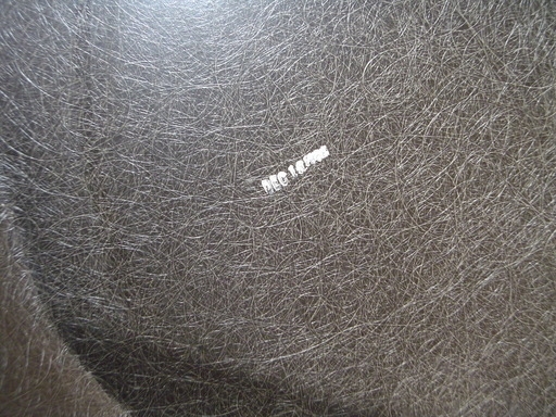

                    Re: Spare tire tub date/part number stamp
                    Dwight,
                    Here's a tire tub pic of my Dec.19th,1966 built coupe. It is stamped 'Dec 16 1966'. Good luck with your stamp!
                    Justin #41362
                    • Kevin M.
                      • November 1, 2000
                      • 1271
                      Re: Tub date judging
                      It was just a store bought stamp, finding one with 1966 now that's a different story.
