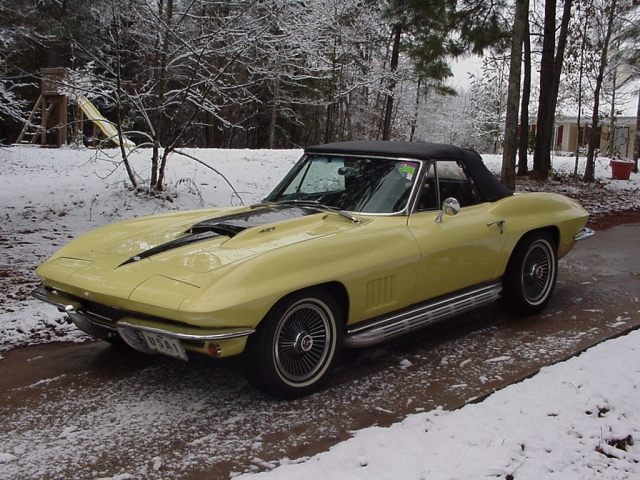

    Where is the license tag bracket on a 427/400 4 speed car located on the front?? And is there and difference on a auto car?/ Looking at a auto car and the bracket is in the middle. Thanks Larry

    if muncie, centered between bumpres. if powerglide , on the drivers side of the nose. mike

      Only 427-390 and 427-400 with AC and a powerglide automatic had the side plate bracket.
