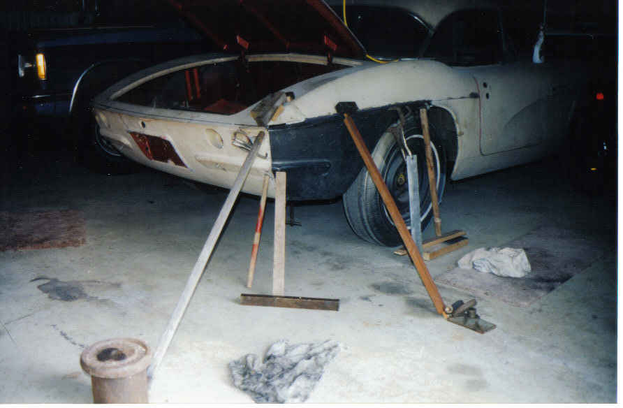

            Re: C2 FIBERGLASS PANEL REPLACEMENT
            61 vette rear quarter panel replacement using no screws.....
