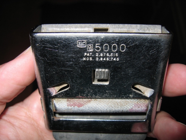

    In my quest for some correct seatbelts for the '62-340, I took a chance and bought a pair of buckles based on the description I could get over the phone. They sounded right for our VIN, #7646. In any case, as the picture shows, there is a PRC marking to the upper left of the CS-5000 stamp on the back of each buckle. The male tongues that came with these are unstamped (no #235) and have the rectangular holes. They have a bit of chrome pitting and surface rust on them. The buckle release handles are pretty tarnished as well. So my questions are:
    1. What the heck is PRC? (was GM sourcing from China in 1962?)
    2. Does this preclude them from being A) ok for this VIN, or B) ok for a corvette? (If they're wrong, wrong wrong, they were $50 for the set, so either it was a deal or I'm 'only' out 50 beans......)
    3. There is a little external snap ring that holds the rod retaining the buckle release. I would like to clean these up after disassembly, does anyone have pointers on cleaning/buffing these so I don't trash 'em? (If I have to ask, I'm at risk of trashing 'em....)

    It appears the buckle you have is correct for your VIN. This buckle was used from approx. VIN 2200 to 12000. It has 2 patent #s and had the letters PRC & CS on the inside boxes. Good Find.

      No mention of the PRC in the Judging manual. Why don't you contact Dave Heitzman at vettes6162@msn.com he is the National Judging Team leader for 62's

        Sounds like you 'done' good!
        I saw a pair of CS-5000 buckles at a major swap meet over the weekend. Condition was similar to what you described and the seller was FIRM on his $200 price....
        On turning what you have into ready-to-bolt-on finished assys, you'll have to consider dismantling the buckles and sending various components out for de-chrome/re-chrome. Then, you have to find correct fabric.
        Beware--there's a difference between the nylon that was used then vs. now regardless of weave pattern. In the 'good ol days' the nylon was appreciably thicker to meet the 5000-lb tensile strength rating (that's what the 5000 in CS-5000 means). Today, improved polymerization techniques allow the nylon to be thinner (less material/less cost) and still meet/beat the same strength rating. Savvy judges can squeeze the belt fabric between thumb and forefinger and tell the difference QUICKLY!
