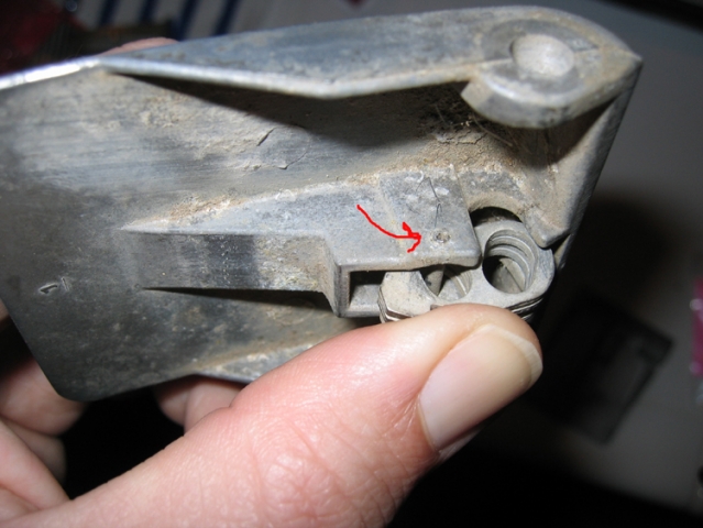

    I am in the process of changing out the buckle tops from a set of CS-5000's I bought for the '62, since the originals have a bit more 'patina' than I'd prefer. Of course, I didn't get very far into the disassembly when I got stuck. One must drive out a small pin which holds the 4 spring-loaded plates in the male buckle top; these plates engage the rectangular hole in the male buckle. See the arrowhead-annotated picture if the description doesn't make sense. In any case, I don't see how to get this pin out (which appears to be flared a bit at its ends) without trashing it. Does anyone have a hint or some BTDT experience? Once these are back together they're headed to Ssnake-oyl for re-webbing. Thanks!

      It appears the pin has a light upset from being center-punched.
      Before I tossed the buckles, one option would be to use a pin punch (1/16" diameter?), and if you have good straight-in access, simply drive the pin out through the other side (brute force finesse). An even better approach might be to use the existing center punch as a pilot to drill the upset off the end, then drive the pin out. Use a new, sharp drill, and apply minimal pressure...if the drill wanders off the pin, that soft buckle material will be badly boogered in a New York minute. Having gotten the old pin out, how do you plan to keep the new one in?
