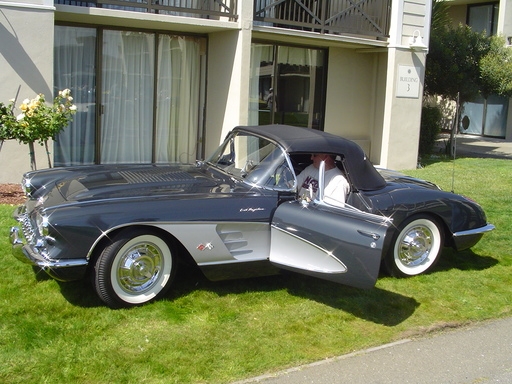

    Dear Members,
    I saw this 58 fuelly early Thursday at the Golden Gate meet. What drew me to it was the exhaust rumble! Are the Fuelly's cams solid lifters? Can I expect similar sounding exhaust from a 67 327/3oohp with Camelhump heads, #490 aluminum intake, 3810 carb, and LT1 cam kit from GM? It's a rear exhaust car and I was looking at the Allen's 'off-road' kit. Thanks much!
