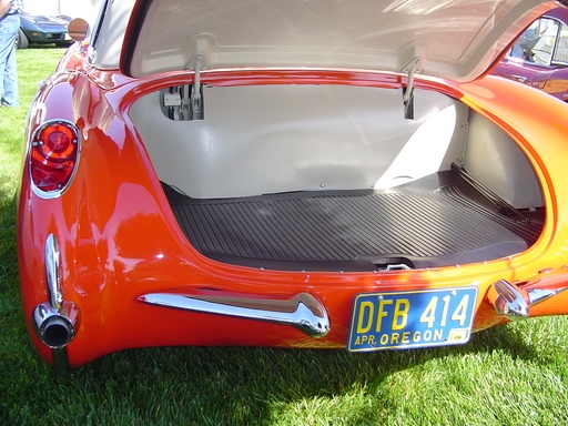

    At Berkeley I judged 56 to 57 , A fantastic beautiful 56 had the wrong design door strikers which the owner didn't realize (first time out for the 56) . Then just looking around found one other vett having the same ones. I posted some time back how to tell original first design from second and third.( I remove the pic.'s after a week ).
    On E-Bay are these nice shined up third design strikers for sale and it's obvious that the pin goes through the housing which the second design is not so obvious but still the pin shows at each side.
    The original Car or Corvette never had the pin show at ether end ( those are original).

    "Hey Roy," You must be Referring...
    ... about this car. I had a nice chat with the gentleman that owns it. He said it sat in pieces for over 28 years and barely had it finished for the Golden Gate. Although my interests are the C2's, I always find your discussions helpful and fascinating!
