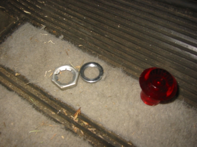

    The assembly manual shows two different nuts used on installation. One on each side of the parking brake bracket. Can anyone verify that there was, in fact, a nut on the back of the bracket?

    Mine has a thin round knurled nut on the front side, and the back side has an approximately 7/8-1" thin hex shaped nut. Both of these appear to be original. I do not have my AIM with me. What page number refers to it. I will be home in a few hours. If you would like a picture I can post it later or email it.

      Rob here are the nuts used to attach the hazard switch.

        Thanks a lot, looks like I need to find the round nut, I have the other. Thanks again...
