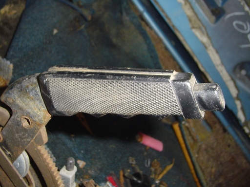

      There is a company in Texas, Mr. G's I think, try www.mrgusa.com They reproduce chromed plastic parts for vintage vehicles. They might be able to rechrome your piece, but I feel there's quite a bit of work for you to do first to disassemble. My car, #6252-Dec 19th 1966, is considered early and I have the all black plastic handle. Good Luck!

          Mine is a May car and the handle is all black like Justin's photo. Pretty easy to disassemble the handle to rechrome the shaft though.
