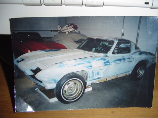

          Re: 1967 Coupe, Yes!
          Bill and John,
          Mine was sitting about 20 years before I bought it! As you can see it needs everything, but still remains totally original. That's Bubba's primer on top of original Marina Blue lacquer. Nothing has been removed except motor and carb. I am currently working on rebuilt block and still searching for correctly dated 3810. I'll be out to see the car soon with new photos for the Forum.
          Justin
          • Mike Murray (25129)
            Director Region V
            • September 1, 1994
            • 1463
            Can't see the interior but, What's that interesting reddish looking thing in the background?
