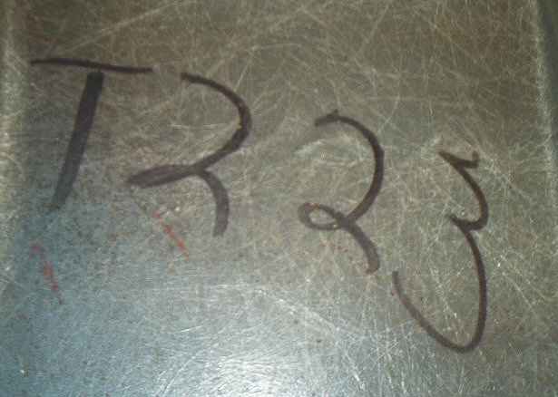

Something interesting on my car. I checked the jack board again and the knock off instruction sheet is glued on. You can see the random glue swirl marks where it is starting to peel back. The repro knock off sheets that I have seen are peel and stick, so mine appears to be an original. I realize the jack board is not definitive, but it's certainly a good indication. Given the rarity of the P48 option, and the rarity of having a "Q" with the job number, it just seems like too much of a coincidence to ignore that both of these situations ocurred on the same car. Also, there aren't any other rare options on my car other than the probability of P48. The original options are L79, red on black vinyl, hardtop, soft top, 4 speed, 3.55 posi, and radio. Pretty standard option package. If any of these options or any combination thereof triggered the "Q", then we would see a lot more job numbers with the "Q".

Thanks Dave! it's looking more and more like they did use a marker in addition to crayon!
Dave, is this an A.O. Smith body? Can you provide the options on the car? If we can get enough cars with a letter designations and compare options and body origin, we might be able to find some correlations. Would be a great mystery to solve!
Only things I can think of that would relate to a "T", would be T01 Goldline tires. Or perhaps teak steering wheel? However, I can't figure out why either of these options would need to be noted in the body line.
All,
In response to the black magic marker alpha numeric character on the rear bulk head, our 66 has the same number on the firewall below the heater box. I believe AO Smith numbered the BODY job numbers in black magic marker A1, A2..A500, B1, B2..B500, etc. If the Smith bodies were intermixed with the St Louis bodies at final assembly, the vin would be approx twice the actual body job number (B500 is actually the 1000th body). Ours works out very close.
Dan, you may be correct. I might be reading way too much into the letter designation. It may be nothing more than part of the sequential job number for AO Smith bodies. Especially in light of the input from Michael. Might just be wishful thinking that there is more meaning to it. Still would be interesting if we can get some verification.
Joe, our cars were built around the same time (my VIN is 1174xx). My estimated build date from the VIN would be 5/13. My Q189 job number probably means mine was about 200 cars ahead of you on the line. Since both of our cars would likely have been on the same of job numbers (1-500), it does give credence to the theory that it's nothing more than part of the sequential, perhaps unique to AO Smith bodies.
