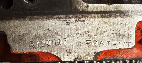

            • Dave McDufford
              Re: Broach Marks, pics, anyone?
              Here is another example of the broach marks. Once you have cleaned the surface off, spray WD40 or something else on it to keep it from rusting.

              • Bill Stephenson
                Re: Broach Marks
                Mike,
                --------I can pretty much guarantee that that "C" wasnt on the pad originally. What was someone thinking?.........Bill S

                  • mike cobine
                    Re: Broach Marks
                    If you notice, that is a T block and not an F, so it was not a Corvette block. That C is WAY off, so most would think it a restamp. Also, the 1 and 9 are not the same as Dave's picture, but then different plants could have had different fonts.
                    Offhand I can't think of what assembly plant is C and too lazy to go in the other room to look it up.
                    It isn't mine, btw, so I can't tell you it is right or wrong with 100%.
                      Re: Broach Marks
                      "C" was Lansing (Oldsmobile home plant).
                      • mike cobine
                        Re: Broach Marks
                        Not too likely a Chevy small block being in an Oldsmobile back in '68, eh?
                          Re: Broach Marks
                          Not hardly!
