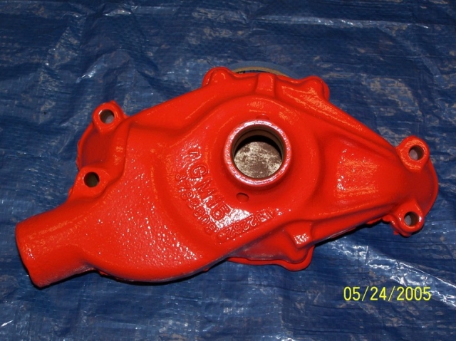

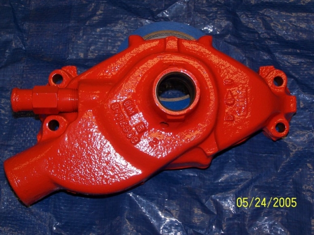

    Which casting would be the correct one for a 327/300 build date L82. I have 2 pumps with same casting number, 3782608, yet they differ in form. I have a rebuild kit and want to know which would be correct.
    The original pump, the casting date can't be identified.
    The other pump casting date is J2262(Oct 22 1962). Would this be correct for my motor.
  • Steve S.
    Infrequent User
    • July 1, 2003
    • 0
    Re: C2 water pump casting varitations
    Original pump on motor.
    • Steve S.
      Infrequent User
      • July 1, 2003
      • 0
      Oct. dated pump.

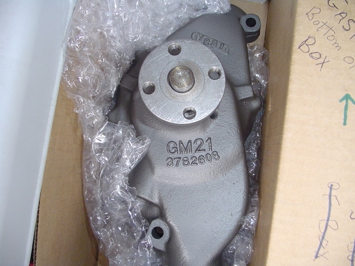

        Re: C2 water pump
        Steve,
        My fourth Ed. 1967 Tech/Info Judging Guide says on page 85 under 'Base Engine' that "all engines use water pump casting number 3782608 without a bypass." Also the casting date code is obscured by the pulleys and shall NOT be judged. Not quite sure about the year of your car, but here's a shot of my recently rebuilt pump. Good Luck!
          Steve----
          The October-dated pump is a Tonawanda casting. This can be easily identified by the "T" casting mark and the reinforcing ribs on the driver's side of the pump. No Tonawanda-cast pumps were ever originally used on Corvettes. The other pump that you have pictured is a Saginaw-cast pump and would be correct as to configuration.
            I've been waiting for someone from the Judging team to jump in here and attempt to answer. Right now in my garage, I have FOUR different castings of 208 pumps, just as they came from the rebuilder.
              Loren -
              Ribs on the driver's side = Tonawanda-cast pump, not correct.
              No ribs anywhere = Saginaw-cast pump, correct.
                Thanks for all your help. looks like I'm rebuilding the Saginaw pump.
