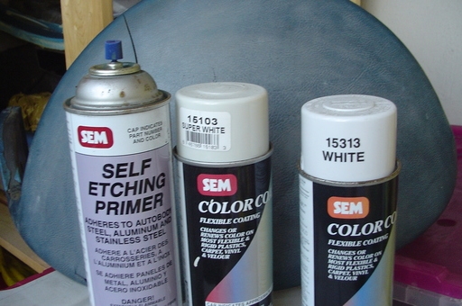

    I did quite a few pieces on my 67 coupe to match the new leather seatcovers which are brighter than old ones. I have found Sem to be the best for interior paint. White was too bright, so I had to use super white to match other pieces. My painter uses it also, and swears by all their products.
    We did a full resto on a 69 280sl Mercedes a few years ago and used the Camel color on some faded armrests. Not only was it a dead-on match, but the stuff is bullet proof and doesn't rub off or peel. Check with them about proper prepping of surface before you color. Good luck!
