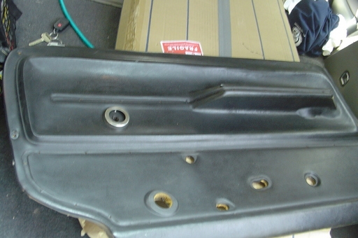

    Dear Members,
    Just got home from Just Dashes out in Van Nuys, CA. The retail to recover my original panels is $1000. I said I could get repros for about $300 from Virginia Vettes, Wilcox, etc. He said he'd do just that.
    1) Are there more than one manufacturer for repro door panels?
    2) Is the labor to make them fit extensive?
    3)Should I try to salvage with what I have and re-color and fix bubbles?
    Thanks!
    Justin #41362
