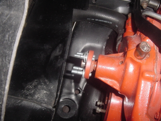

    Also I have a pic of my water pump, it has the correct date and part # but it has studs instead of bolts. Is that correct or not?
    Link to pic here>

                  Re: 1967 427 3x2 linkage problems "help"
                  Hi Don, thanks but the pic will not load up for some reason.
