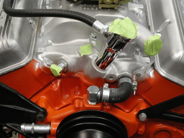

                      • 11608
                      Re: Neither do I...!
                      Here's my take on it, for a 1966 327/350 I repainted.
                      As per Flint, I did orange and then silver.
                      Patrick
