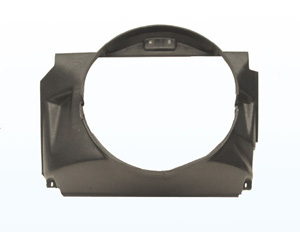

                My 3956119 looks more like the Dewitt#458 *NM*
                • george culolias
                  Mine looks like the 458 also. I wonder why?
                  Why all the vendors say it is supposed to be the one Dan showed a picture of. I hate to pay $400 for a fan shroud but I might have to. Oh well time for a second job! Thanks everyone for helping me!

                    The picture you show is NOT a 119 shroud *NM*
                    • Dick Whittington (8804)
                      • July 1, 1985
                      • 10485
                      Re: The picture you show is NOT a 119 shroud
                      Good catch Doc. Apparently he copied the picture above the listings for shrouds. The picture of the #458 looks correct for 69-72 and probably looks like the ones you have on the shelf.

                        119 shroud is Disco; only 1 spare NOS 4 me *NM*

                          Re: 69 435hp fan shroud?
                          Here is the correct page and the part was just discontinued by GM
