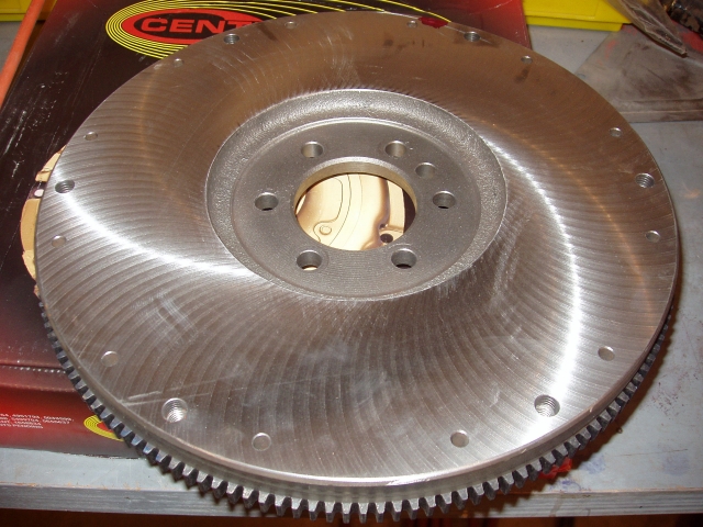

Who knows how a flywheel is resurfaced? I have had my flywheel resurfaced twice now by a place that came highly recommended, who does them for many area shops. I had chatter after the first time (see other threads from me about that) and found I had some non-uniform runout of about .004". I took the flywheel back and they redid it and claimed they did see a problem and made sure it was good this time. Now on the car I have more runout than I did the first time, something like .010" now! At least this time I checked it before the tranny went it! Since I know someone will ask, I checked the crank flange and I measure no noticeable runout at all on the flange. I marked the high and low spots on the flywheel and they are 180 deg opposite, and if I remount the flywheel 180 opposite on the flange the same high and low spots remain. This confirms that the flywheel surface is out of plane with the center where it bolts to the crank.
I was thinking that maybe the machines they use to support the flywheel uses the center hole to attach rather than the actual bolt holes? Anyone know how this is done? The tech said their machine uses some sort of stone that spins. The finish has been nice and uniform, but something isn't right. Should the flywheel be cut with a cutter like how brake rotor is turned??
