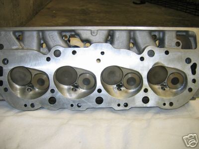

    Here is an '842 head that shows almost an identical combustion chamber.
    • Steve Antonucci
      Re: 427 Closed & Open Chamber Pistons
      Here is a 3919842 "closed" chamber head. This is what I would expect them all
      to look like. Yet, a previous image shows a more '074-like combustion chamber
      found on another '842 head. As a matter of fact, if you search eBay, you will
      find two or more '842 heads with this same open chamber design. Any thoughts?
      Could these have been owner modified, or cast that way? See how confusing this
      gets.
        Steve,
        In mid/late 1969, it seemed everyone that was racing anything with a 1st design L88 wanted the new open chamber heads, especially the Pro Stock Camaro guys. Some bought new OC heads but many just had their 838's modified to be open chamber. It was "the thing to do" in that era and it seemed just about everyone did it. They expected tons of new found horsepower. (it didn't happen)
        I've never seen an original 838 head that was factory open chamber. Any that we see today have been converted. There's no logical reason why GM would have been making these heads with an OC design, especially because of the fact that they were still being used for service.
        • Steve Antonucci
          #19
          Michael,
          Thanks for the historical input. I thought this might be the case.
          So, I now have a new question in response to your post. If one is trying to
          lower the compression ratio to a more useable number ( 9.5:1 ), will this
          combustion chamber modification to the '842 heads lower the compression ratio
          by any significant amount? Do the '842 heads have enough wall thickness in
          this area ( adjacent to the spark plug hole ) to facilitate this grind back?
          Do you run the risk of getting into the water jackets? Can they be welded
          up if you do hit the water jacket? Is it worth it today? I'm leary about
          laying back this area in my stock '842 heads. What do you think?
          Steve
            i have seen this done and no problem BUT i have also seen them leak. aluminum castings back them were not that good and i have had stock ones we had to "water glass",sodium metasilicate, the water jackets to stop the leaks. we used "water glass" to preserve eggs back during WW II. NEVER try to "open chamber" closed chambered cast iron heads because they all will fail.
              Steve,
              I think your last question, "is it worth it today" is probably the most important one. I suppose it really depends on what the end use for the engine is going to be but, all in all, no. The overall design of the heads is actually just slightly beyond caveman by todays standards so if your looking for serious HP, look elsewhere. There are a number of later design heads that look similar, externally, but produce much better torque/HP numbers without spending thousands on old obsolete parts. Truth is, there never was a great HP increase as a result of the open chamber design. Certainly not enough to justify spending a lot of money to convert.
              The problem you mention about "accidently discovering water" is quite possible. I've never actually had that happen to me but I've sure heard a lot of stories about it over the years. Aluminum is actually easily repairable but, again, the cost of all the machining is not near worth the results.
              If I were going to build something that LOOKED correct for a period restoration with 838 heads, I would consider flat top pistons if I was going to drive the car from time to time. That would probably drop the CR numbers down to around 10 or so. (I would have to run the numbers to get actual CR).
              On pistons, I think Joe Lucia has good information about what's actually available today. I don't get involved in engine building now so I can't make any recommendations.

                Steve-----
                I would say that these are definitely converted heads. Note that the "open" portion of the combustion chamber appears to have been "ground"; it is not the as-cast appearance seen in factory, open chamber heads.
                Quite frankly, the heads HAVE to be converted irrespective of the above. There's no way that GM would have made open and closed chamber heads with the same casting number. As I've mentioned previously, the combustion chamber configuration is part of the casting. If anyone got the idea that the factory would have converted closed chamber heads to open chamber, the idea is absurd. First of all, such a conversion would have been WAY too labor intensive for a factory operation (assuming that the heads were a normal PRODUCTION or SERVICE piece; a GM "experimental-type" piece would really not be a lot different than a field converted piece). Second of all, if the factory had made such a conversion the chances are very great that the casting number would have been ground off, in whole or part.

                  Joe,
                  The grinding-off of the casting number is a very good point. I have seen
                  this done ( at the factory ) to modify the 3933163 intake to the 3933198
                  ( open plenum modification ) for ZL-1, L-88, etc..
                  Now that others here have commented on the commonality of combustion chamber
                  mods back-in-the-day, I know why I see '842 heads with an open chamber-like
                  appearance.
                  My thanks to all.
                  Steve
