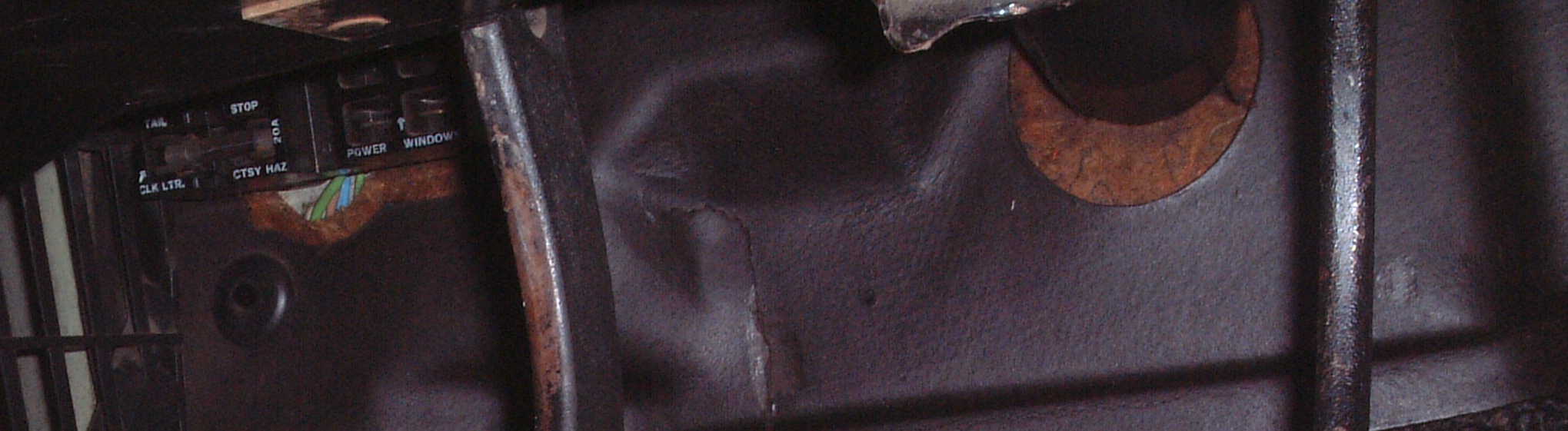

    The photo below shows the material I received. I can see where the upper left piece fits, but I struck out on the others. The pieces of string mark serated lines which I assume are intended to separate the material into several pieces. I need a little help placing the other pieces. There are only a few places under the dash, and I'm a tad embarassed that I can't visualize the placements.
    Steve

      I do not recall how mine went together but I did not cut any of the parts. Match the holes up to holes on the firewall and then bend the pad around the corners. It does fit. Once the large piece goes on, the location for the smaller one becomes more obvious.

          Here are a couple of photos of the insulation installed. DO NOT CUT IT APART!!!
          It fits as it is diecut..... Just spray the area with 3M Spray 77 adhesive.
          The original insulation was a tan color so you'll receive a few point deduct for originality on the gray just as I did.

              Thanks for the photos. Now I see.
              Steve
