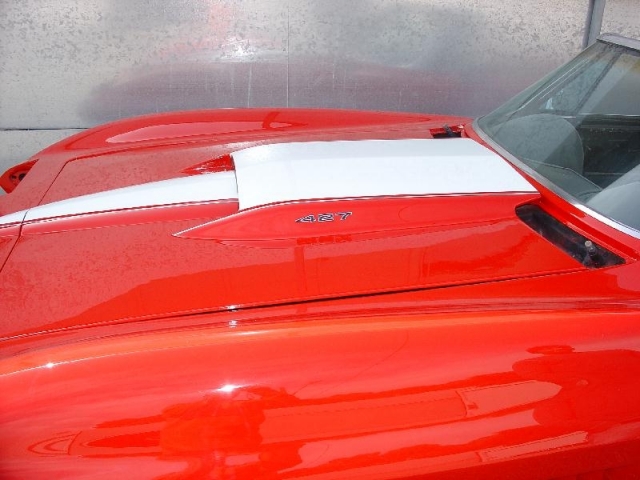

      Douglas,
      Grady and I took this one all the way around the edge. The brilliant shine is not from lacquer, but Glasurit. We also started with a stencil from "Year 1" but it was so bad, it got tossed away. The job was done by hand with careful masking, assembly measurements, and lots of patience. It turned out awesome, but please ignore the edge gap from the repop hood.
      Justin #41362
      [/IMG]

        Hopefully Picture! *NM*
