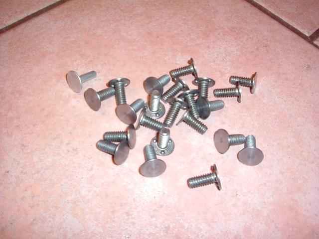

        Re: C2 roadster door
        You can also use 1/4 - 20 "weld studs". I used them on my C2 doors. The head is thicker than the rivets, but turning them down in a lathe was easy. McMaster-Carr has them P/N 93865A220 for about $12/100.
        Hope this helps.
        Mark
        #27152
        • Mark S. Lovejoy
          Here are a few after lathe work.
