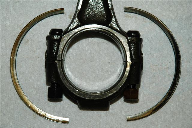

    Is the rod (pictured below) a 67+ second design or pre 67 first design? With all the talk about early rods being the weak link I would like to be sure.
    From previous posts, I thought the slight bumps at the 10 and 2 o'clock positions on the rod face were telltales of the beefier second design. The problem here is these rods came out of a original late 65 motor..... hmmmmmmm.

    It appears to be second design. It's never been clear to me when they went into production. I thought is was the beginning of the '66 model year, but maybe some late '65s had them. Chevrolet realized that the first design was weak and such a change is easily implemented as a "running change" whenever the new design parts are available.
    The first design was definitely weak at the bolt seat - that's where they typically break, and those little humps of material adjacent to the bolt seat signficantly improved this area's strength, which improved fatigue resistance and makes a for a much more durable rod.
    These second design 327 rods are okay for a 300 HP and are probably okay for L-79, but somewhat "iffy". It was the high revving mechanical lifter engines that needed them, but by the time they were available, these engines were out of production or nearly so.
    In any case, I would have them Magnaflux inspected, and if there are no cracks, I think they're fine to reuse for a 300 HP engine rebuild.

                      why not GM PM rods #12495071 and king spacer
                      rod bearings,use 2.100" rods on a 2.000" crank pin. rods $250 for 8 and king bearings $80 total $330 and no balance problems and the rods are good for 500HP.

                              the king spacer bearing # CR867HP
                              and they are available thru holleys lunati brand
