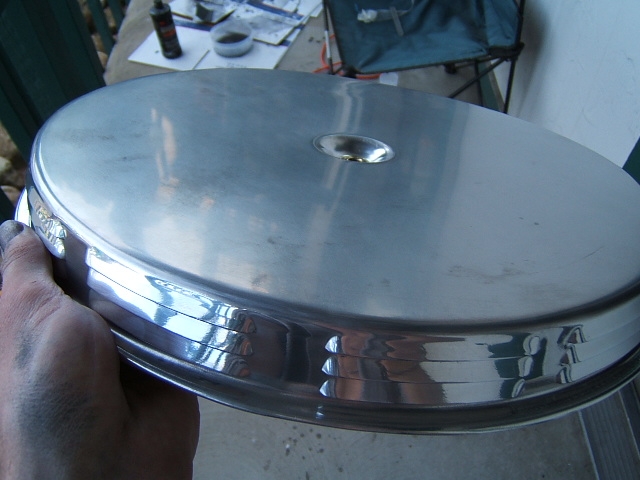

    How do you tell the difference between a original and a repop? This is the 60-62 air cleaner that is going on my 1961. Are there any give a ways? There are many more pics at the link. Thanks all.

    Differences are in the "tip out" of the louvers, (originals stick out furthur) and the size and spacing of the flat spots between the louvers.

      First it's to shinny and the biggest is that brass ring holding the inner part together, original was spot welded
