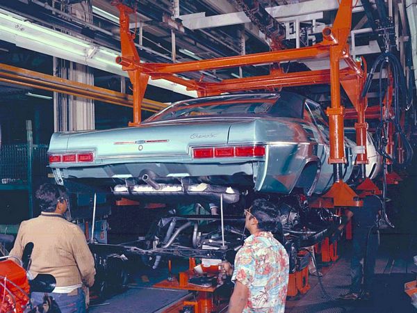

                Here's a picture of a '66 big block about to meet it's body. You have to look in the lower left corner of the photo. I hope this helps answer the question about '66 Tonawanda big blocks at least.

                  Excellent Pic
                  Thanks Verne.
                  That's EXACTLY what I've been hoping to find for many years. It clearly shows the manifold heavily coated in orange. I've been whining about this for at least two decades and finally we have some proof !! Hopefully, this will end once and for all the debate about how much paint was on these things. It was NOT a mist coat. The outer surface and both ends were seriously blasted with orange.

                    I'm glad I was able to help. I had no idea there was such a debate over that detail. It's too bad the cameraman wasn't back a couple more feet. Unfortunately, I don't have any pictures like that from the C3 era.

                        That exhaust manifold really looks like the paint was applied
                        in a deliberate manner - huh?

                          Re: Excellent Pic
                          Yup, sure does Steve. The worker never stopped moving the gun and never took his fingers off the trigger as he was covering the side of the cyl head. One shot from end to end with paint pouring out of that nozzle all the way. Actually, the manifold runners received more color than the cyl head itself. Certainly not the way most restorers would do it today but it would be absolutely correct this way.
                          They sure look good after about 15 minutes of running when most of the orange on the runners turns black, leaving orange at the flange and some areas of the runners.
                          Just my opinion but I think glass beaded and clear coated manifolds on a 65-67 big block look like they belong on a hot rod, not a restoration.

                            Re: Excellent Pic
                            That would mean that there should be significant shadow under the manifolds? Interesting. I sure would like some if not all available photos for restoration work. I'm having a hell of a time with a 68, 442. Seems 68s a one year wonder GM wide!
