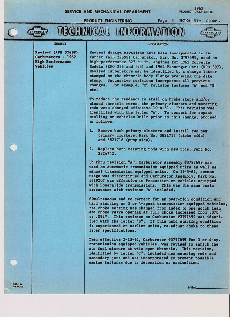

    I recently received a friend's 3460S AFB which I plan to restore for him soon. The base flange is stamped BD3, which I know is an April, '63 carb, and it's the second revision, (B). The carb appears to have been through a rebuilder before, so I can not be certain that the parts in there now are the ones that should be there. The only Carter specfications I have are for the original version of the carb. Please take a look at the Technical Information page I posted, which pertains to the '62 Corvette AFB revisions as an example of what I need. I do not have this information for '63.
    I'm hoping someone has the information to explain the specific components which were in the "B" revision (also including the "A" revisions). Of course, I realize that I may have to make my own revisions to make it function properly with today's high vapor pressure fuels, but I would like to start with the correct Chevrolet baseline.
    Thanks in advance. As for anyone with a '62 who can benefit from this information, I'll be glad to send the second page to you. Just let me know.

              • Verne Frantz
                Re: AFB carb revision letters help
                I have all of the original Carter specs for the FIRST OEM versions of the carbs. I would very much appreciate seeing the same type Technical Info sheet as I posted, but one from a '63 Product Data book which would outline the "B" revision, available by April for the 3460S.
                The "B" I'm referring to is the letter preceeding the date code on the base plate flange.

                    • Verne Frantz
                      Hello Chris,
                      Take a look again at the blue Technical Information sheet I first posted. It's chock full of great information, however pertaining to a '62 carb. The first "version" of the carb was not the "A". There would be no letter at all on the first issue. The "A" signifies the first "revision". A "B" rev would include the "A"; a "C" rev would include "A&B" revs, etc, etc. I will list the info I was able to dig up and try to present it in date order. Keep in mind that my carb (3460S, P/G hi-perf) is an April build, rev. "B". Duke's 3461S (man. trans hi-perf) is a Feb. build and rev "C".
                      ----------------------------------3460S---------------------------------------
                      Source--------Pub.Date--------Pri. Jet---------------Sec. Jet---------Rod-----
                      '63 Shop Man.--?/'62----------.104"-----------------.0689"---------.069"-.060"
                      '63 P&A--------11/'62---------.104"-----------------.0635"---------.073"-.063"
                      '64 P&A-------10/'63----------.104"-----------------.0635"---------.073"-.063"
                      Carter Book----8/'64----------.104"-----------------.0635"---------.073"-.063"
                      ---------------------------------33461S---------------------------------------
                      '63 P&A--------11/'62---------.104"-----------------.070"----------.069"-.063"
                      '64 P&A-------10/'63----------.104"-----------------.070"----------.069"-.063"
                      Carter Book----8/'64----------.104"-----------------.070"----------.069"-.063"
                      Note: There are some descrepencies with the listed size of the 120-176 secondary jet. I hope this helps and doesn't just add to the confusion. The one thing that stands out though is that the sizes are listed the same, both before and after the carb build dates, which indicates to me that only the original specs were printed. So we still have no way of knowing what changes were incorporated in the letter revisions....??
                      Verne

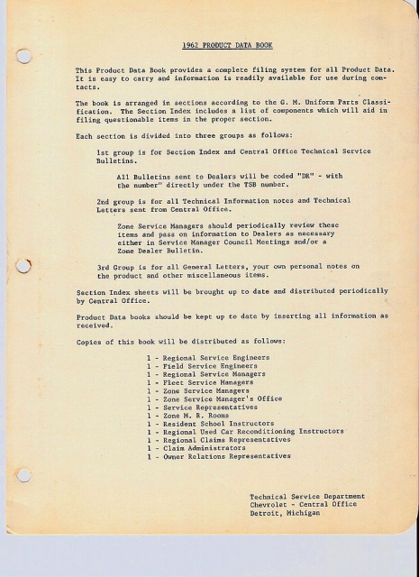

                        "Product Data Book - Technical Service Bulletins and Technical Information" sounds like a valuable reference for our outfit but I have not heard anyone talk about it in my short time browsing this site.
                        Is this a common document?

                          I wasn't familiar with the term until Verne brought it up. It looks like a binder to place TSBs and other service information that dealers received on current model year cars.

                          • Verne Frantz
                            Chris,
                            I can't explain what a Product Data Book comprises any better than Chevy themselves did, so I've posted the first page of the book to better describe what it is. There is also an index leaf at the back titled "Engineering Specifications". That section in my book is complete for all '62 Vehicles, including trucks, and it also includes all the RPO descriptions and dealer column-ordering codes for options that aren't even listed in the Finger Tip Facts books.
                            I would have thought (hoped) that more would have surfaced by now through literature dealers. But the last such book I ever saw for sale was around 1980.
                            Take note of the distribution list of these books at the bottom of the page. Perhaps someone might know how to contact one of those original recipients of the book and make a polite inquiry.
                            Verne
                            • Chris D.
                              • November 1, 2002
                              • 198
                              Verne,
                              That is quite the document. You should post this first page picture in the thread you started earlier today.
