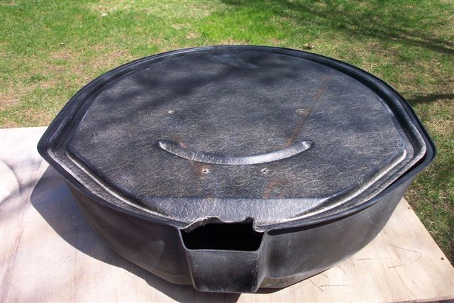

    Is there any difference in spare tire carriers for 63 to 67 Corvettes? I have accumulated several over the years and am not sure what year cars they came from, but I do know they were all removed from mid years. As always, thanks in advance for your help.

    Rex, yes is the quick answer. The first carriers, 1963, has a small lip on the tub and the cover. Best I can remember late 63 to the end of production in 67 were all the same.
    This is a 63 carrier.
    Harry

        Joe, the front lip is a tiny bit frayed. The photo looks worse than it really is. It took me 2 months to rebuild it. The cover had a 1 inch by 10 inch piece missing and the tub had a 2 inch by 14 inch piece missing. Lot's of cloth and resin and sanding.
        Harry
