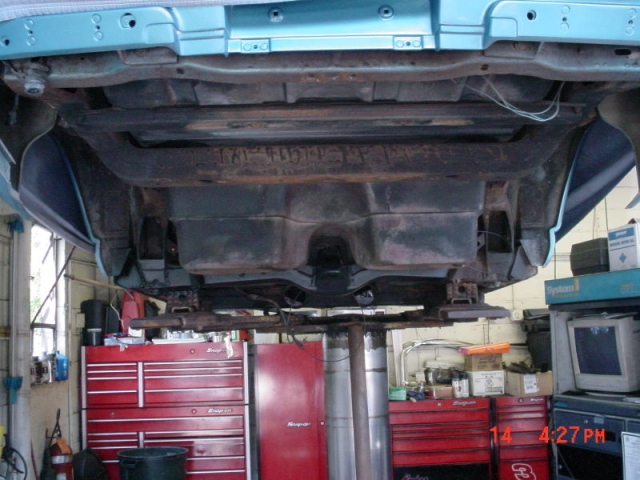

      wire was attached at top of firewall - i cant remember exactly without looking at it - check out the pic

          if your 65 left st louis with backup lites, then the harness from tranny to the plug off dash harness(top left engine side of firewall) then the wires will both be BLACK with a dark pink stripe on one of the blacks and a lite green strip on the other black wire. the pair of striped wires are molded together. a solid pink/solid green or any combination of colors other than those i described above would indicate service replacement harness/switch. the correct double black with a seperate dark pink and a lite green strip is extremely difficult to find. your picture appears to be a purple and a black but the details in the pic are difficult to interpret. mike

                      i will look on monday - thanks to all - i cant tell from this picture - but it looks like outer socket is double
