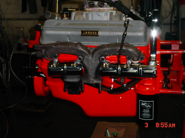

    What does the left side exhaust manifold look like for a non-A/C car. Mine is a reproduction 3846563, and presently has provisions for a LH mount alternator. Should this forward end be plain, or should it have a boss with two threaded holes facing forward? What do the "seven rectangular projections" on the top look like? Pictures are worth thousands of words, but words will be appreciated, too.

    joe - they all have that - i have an original - see pic

      Joe,
      Yes the LH "563" casting should have the forward facing boss as you describe. The "seven rectangulat projections" reside along the top ridge along the center of the casting. they are about 1/8" wide X 1/2" long and stick up off the surface about 1/16".
      You can see what they look like by clicking some of the pictures on the auction below. I believe the reproduction part look different here and later service replacements have these ground off.
