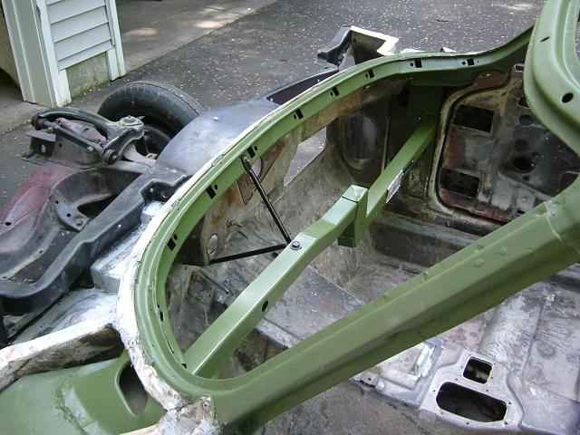

                            Re: Birdcage primer
                            Here is what my original cage green paint looked like.
                            Chuck
