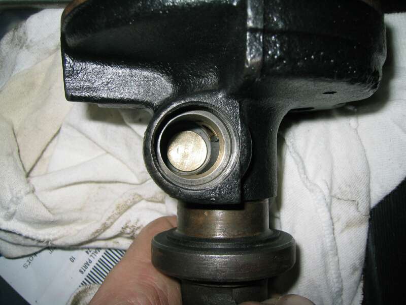

      the button you refer to (be it nylon or brass) was not present nor was a receiving hole pre-drilled in Distributors that were supplied with C2s. Both Brass and Nylon buttons for this purpose are available from a few of the usual sources, including LICS. As I understand it, rebuilding a distributor with noticeable slop in the cross-gear due to wear in the area of the distrib housing will soon result in what you encountered. While I myself did not install a button when I rebuilt my (65) distrib, many have done so by drilling a [centered] hole in the back side of the distrib housing to receive the button "lug", if there is a worn area that will serve as a guide. Some are careful not to drill all the way through, others simply do so and touch it up with some JB Weld and then repaint. I have also heard of real show-offs installing a screw from the outside in that permits adjustment of the gap / tolerence.
      here's a picture I swiped from a friend's web-site showing his brass button installation:

        With care, it is not necessary to drill all the way through the housing to install the brass button, so the installation can be undectable on a C-2 when it is on the engine.
