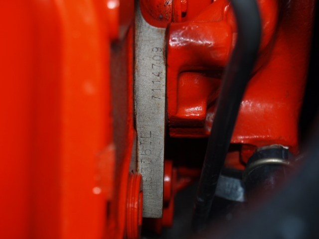

    like the large headlights, not the large pad stamp

      Re: Do you mean the tires, or the headlights?
      Its amazing what 100K will buy + a car. D/

        Is that transverse broach marks
        and an extra digit in the pad stamping?
        Solved the spelling problem this time, but looks like he can't count.
        Maybe the stamper was distracted by the demonstrator

          A Tonawanda number stamp package with 8 characters?? This one's going to go in the same folder as the Fonawanda restamp. Both will be in the running for first place in the wackiest restamp contest. Is this really the engine from the ebay 67?

              Re: like the large headlights, not the large pad s
              Yes, this is really the one.

                "TOONAWANDA" fits better..at least it's a T not F *NM*

                  Also seems odd that the tip of the water pump
                  casting is so high above the pad. I'd say this block or at least the pad has had some serious mill work done to get that low.

                    Tied For First Place
                    I dunno Patrick, I really like the Fonawanda stamp also. Both have such character and uniqueness. Difficult to choose.

                      And on both of them the broach marks look like they were done by my 7 year old working on an art project with 120 grit paper.

                        Musta been a helluva leap year to get built on March 316th

                          They look like a set of bolt-ons to me!!!! *NM*

                            Seems like I remember one a while back on ebay that was stamped something like Jan 54th, or maybe it was the 14th month?? We sure get some strange "original blocks" on ebay.
