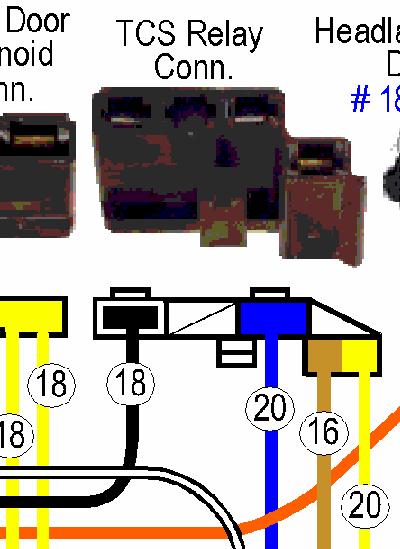

      If the colors match these and the connector looks like this, then that is the TCS relay. It will be difficult to find new, since it is discontinued. It may fit other Chevrolet car lines in 1972, although that is just another avenue to explore.
      Neither the early 72 with the seat belt timer, or the later with the seat belt buzzer and seat belt relay have any circuits in common with the TCS circuit, except they both draw on a 12 volt battery.
