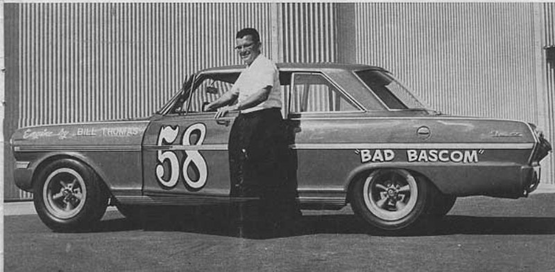

                            Whatever happened to "Bad Bascom"?
                            The Chevy II Thomas built for road racing with the C-2 Powertrain/driveline in it?
                            One of the test mules wound up in England after being wrecked in it's last race there.
                            • Verne Frantz
                              Re: Whatever happened to "Bad Bascom"?
                              Mike,
                              Bill Thomas' original Bad Bascom did get crate '61 F.I. motor, as well as an independent rear for awhile. He later replaced the engine with a '63 427 (Z-11), went to a dropped steel front axle and replaced the rear. Dick Harrell bought the car and continued to race it as the Retribution II. The car went through some body, color and moldings changes along the way. It's rumored that the car was destroyed in a crash in '65. A "tribute" car is being constructed now.
                              As for overseas racing, you might be thinking of the fastback conversions that were originally made for road racing, but most all of them wound up on the drag strip.
                              Verne
