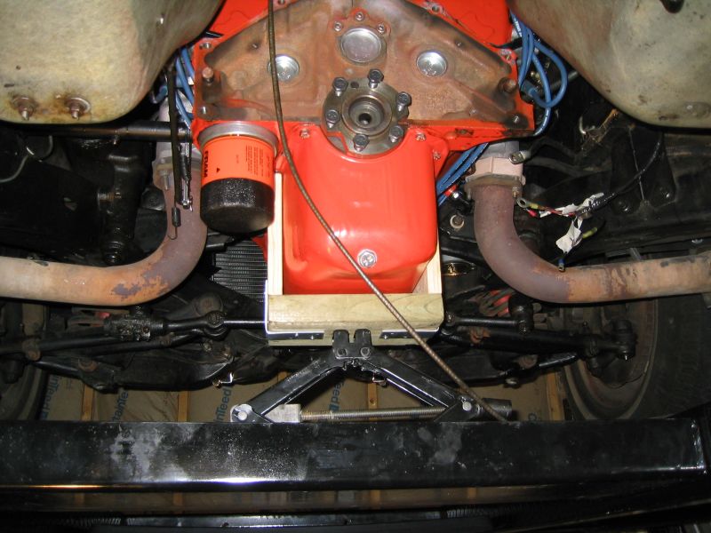

        If you mean the one to use when jacking up the engine without denting the oil pan, the photo is below; the base is a 2x6, and the sides are 1x6. Crude, but effective.

              John thats the one Thanks! I thought I saw a print or sketch posted here about a month ago but I'll be damned if I can find it in the archives.
              Tell me, what part of the motor rests on the top of the 1x6 uprights. And the notch, is that to clear the oil dipstick?

                  The pan rail (where the pan bolts are) sits on top of the side pieces, and the notch is to clear the dipstick "bump".
