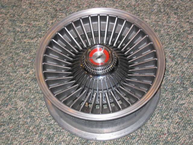

                    And here's what an original wheel looks like.
                    Boy, every time John shows that Chinese wheel, it's almost hard to believe they could mess up the fin size that much. Here's an original wheel for comparison. The Western wheel comes real close, but that Chinese wheel....

                      • Dave K.
                        • November 1, 1999
                        • 951
                        Re: '66 reproduction knock off wheels
                        John,
                        I suspect that the Chinese were having casting problems with the vanes cracking and decided to make them thicker. Results in a rather ugly looking wheel.
                          Actually, it looks like they have reverted back to the practice of using only one mold for both K/O and Bolt-on wheels. The original K/O wheels use a much thicker fin than the bolt-ons, amd when reproduction bolt-ons first came out they all carried the wide fin. I haven't kept up with more recent repro bolt-ons, but the picture of the current wheels sure looks likt a throwback to about a 20 year old reproduction..
                          Bill Clupper #618
                            • 11608
                            I'd suspect that John is correct. The people at Corvette America have no idea how to spec out this job and how to set the standards of what they would like made. As my Dad's job is all about helping people do exactly this type of thing, I can tell you that Corvette America got exactly what they asked for. They just weren't smart enough to ask for the right thing.
