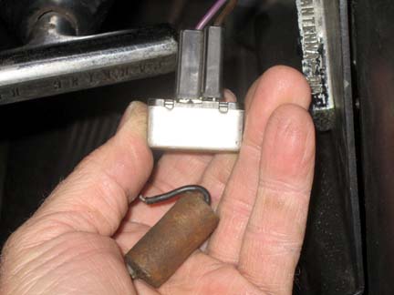

Can anyone tell me what this part is and does the resistor need to be attached to it. It is under the dash near the brake handle. When I reached down the "resistor" or whatever it is fell off. Help!

Yes they were connected but not necessary. Radio equipped cars had condenser attached to many circuits including turn signal flasher. The condenser had 2 metal tabs that attached to the flasher terminal before attaching the connector to the flasher.
My 66 does not have the condensor. May cause some radio interference when turn signal is on.
