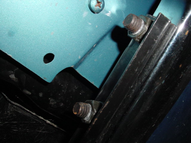

              PT,
              This was just on "the other board" 3 months ago.
              Here's a picture from John Hinckley:

                  Terry -
                  That screw was always a round-head phillips on 67's as shown in the photo Pat Hulst posted; '68-up were different.
