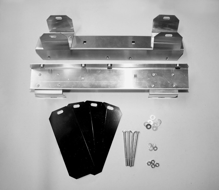

    Just a heads up, we are now making these. What use to be very hard to find side brackets for a special high performance 1960 or early 61.
  • Thomas D.
    • May 31, 1987
    • 120
    I forgot this photo

        Re: New Top Tank Brackets, Painted or not?
        I know the radiator was unpainted when it was installed from the assembly line. My question is were the brackets unpainted also? If they are painted what gloss of black? Are the brackets alluminum also?
        • Dennis C.
          NCRS Past Judging Chairman
          • January 1, 1984
          • 2409
          Bill, Brackets are aluminum... In my experience...
          ...I have mixed findings on paint, but my best guess at this point - NOT...
          • Thomas D.
            • May 31, 1987
            • 120
            Re: Bill, Brackets are aluminum... In my experienc
            I agree, no paint. Many of the old ones I find have some kind of black paint but it is never under the rubber cushions and looks to be non-production.

                Thank you, No paint it will be! *NM*
